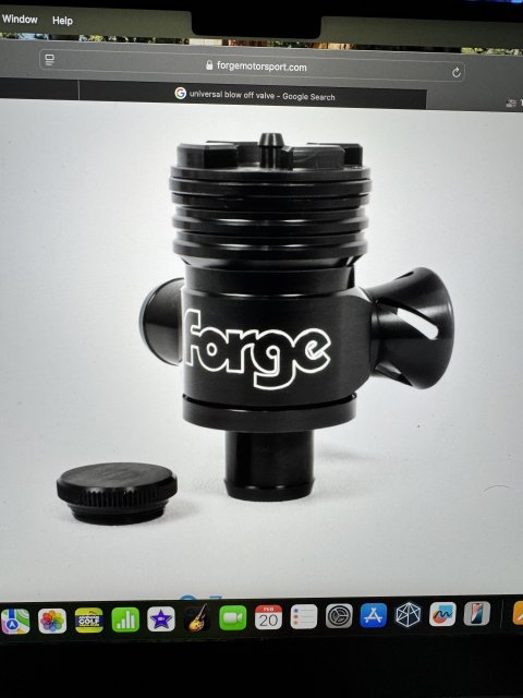

yeah I was reading about that. You need to get a OEM 21-24 connector with the rubber end and then you can connect the FenFab pipe. I did take my airbox out and saw where the recirculating valve use to be. There is actually a blank fill where it use to be. Something like this might work
5,630
6,803
I gave you the info to do it right. If you wanna rig something up and half ass it that’s on you.
