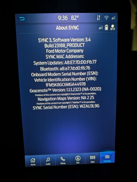

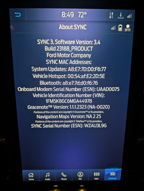

This is what my screen said BEFORE going to the Ford Dealer, I did not drive the car today so I can't send what it says since I got it back from them, I will post it later tonight or tomorrow.
I know 2 things are missing from the screen since it was returned to me...
