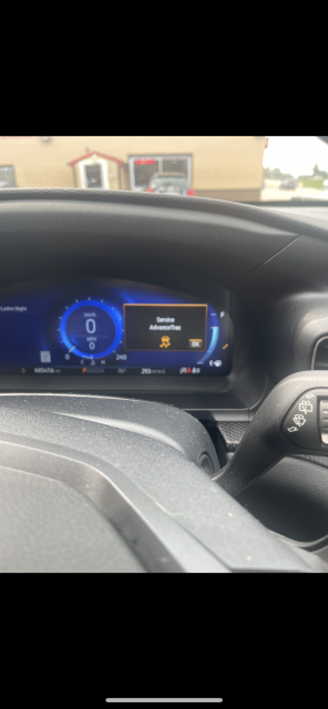

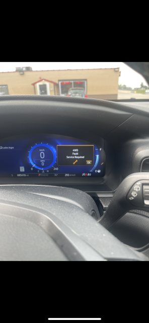

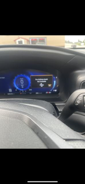

I have a 2020 explorer ST I’m getting these notifications trying to figure out what is the best route for fixing this issue

There are several different OBD codes for the same warnings which will result in different repairs. I've had the half-shaft speed sensor replaced, then the FADA TSB and most recently the AWD Module replaced. All were either under powertrain warranty or extended warranty. My advisor said they also do software updates for any of these repairs.

There’s a recall for that. Bad AWD module. Needs to be grounded.

Thise are just dash warnings. You need to do a diagnostic scan to find out what’s wrong. Personally I’d get the OBDlink MX+ and Forscan Lite

Just had the same thing, my rear differential needs replaced.

Ok thanks I’ll look into that I was also told being that I replaced (1) tire it’s throwing off the traction

I've had my rear differential replaced along with transfer case twice last year.
