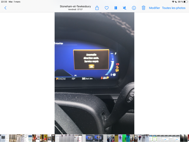

I own a Explorer ST 2020 since august 2020. I am almost 6000km done so far with it. Last weekend i had an issue (
) preventing the car from starting. I had to have the car towed to the dealer because i was unable to have it start at all.
Monday morning i spoke with them and they said the car started like a charm and they can't reproduce the problem. I provided them with the video linked above but so far no luck.
Anyone can help me ( help them ) pinpoint the isssue ?

This post is a little old...BUT I'm still having the "it won't f'ing start" problem! Lights flash, dash flashes...blah, blah, blah. 10,400 miles
Been towed two times. Replaced the battery one time. Same problem.
Pearson Ford (Zionsville, Indiana) has had it for 10 days..."we can't replicate the problem".
Has anyone heard of a direction to point these clowns? Something to try?
At a complete loss...other than sell it.
Thanks!!

There is a difference. This problem is not cranking at all. It seems like an electrical or electronic/software issue. My problem with the incline and less than a quarter tank was fuel delivery. So it cranked but wouldn't start. Another time it stalled up hill with 3 gallons left and burned the fuel pump.

Yes...starting on level ground. It doesn't crank at all...just the lights flashing and zero noise related to the engine attempting to start.
Dealership still has the car...we're at 2+ weeks and they've made zero progress. I'm guessing they're not even trying at this point...
