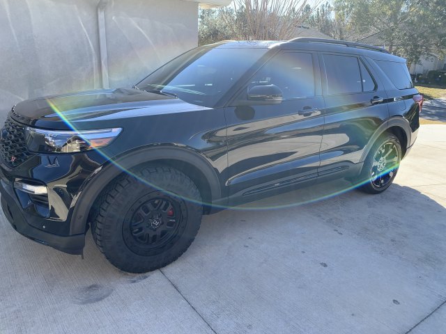

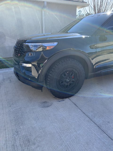

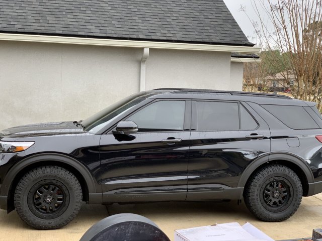

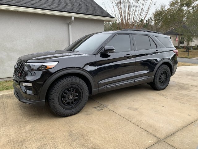

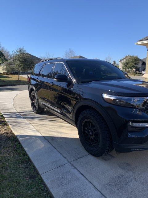

For those (few) of us that want some meaty tires, I took the plunge and rolled the dice to see if they'd work. Still waiting on the rears to arrive this week.

Yeah , that's meaty.
I like the looks,
Wonder how it's going to affect ride and handling.
Looks like it's ready for off road for sure.

Thanks! Ride should be quite a bit better than the stock 21s as the larger sidewall makes for a much cushier ride. I've had Duratracs on my last 4 vehicles and love the look, ride, and offroad traction. Very quiet on the road too. Handling shouldnt change much and my track is now about 0.6" wider than stock.

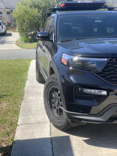

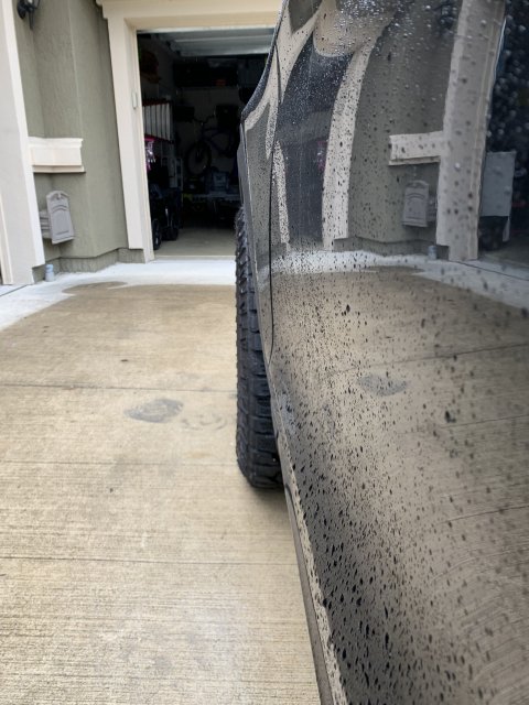

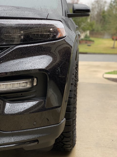

I can confirm now that the 0.75” front spacers BARELY fit. They rub the wheel liner ever so slightly but give it the perfect amount of tire poke. No binding from lock to lock. A 1” spacer would def hung up so I got very lucky.

#20
I don’t believe in luck – it was meant to be and looks perfect - props
