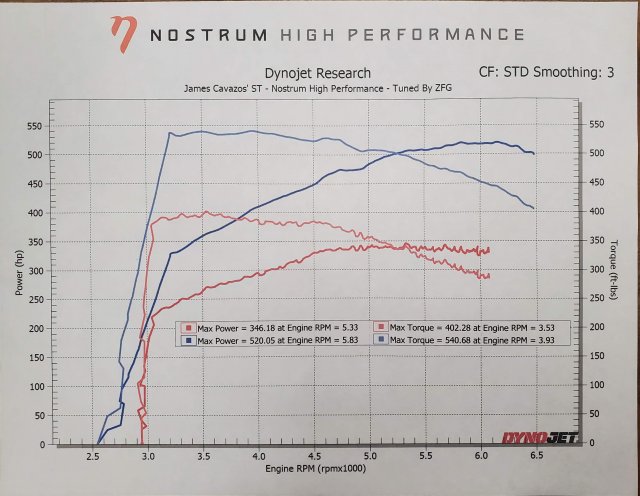

If your dynos are correct at 520, you should be in the same range. Another ST dynoed at 504 was at 11.89. Unbroken (I'm sure he'll be happy to detail it) has some pretty significant savings in wheel and brake weight.

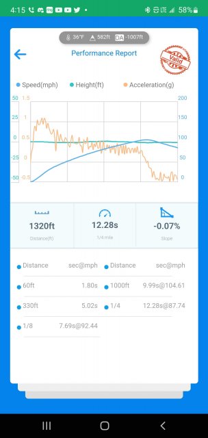

Didn't have the room to finish had to brake near the end. 7.69 suggests around 12.0 though. Still to see 12.2 knowing I let off is cool.
3.96 0-60
3.62 with 1'

The first sentence is incorrect. The oem fuel system will support E50 flawlessly. That can net 3.6X 0/60’s and 11.6X 1/4’s at 117+
So now that I've got an idea of what my times are; I'd say there was 0 reason for me to spend 4 grand on the fuel system. It didn't do anything if the stock fuel system is cranking out the same performance as what I am doing now. Am I missing something??

With that 0-60 you should see 12.0’s on 93. Maybe have been covered already but do you have an intercooler in it?

Just play with it…you’ve got a lot more in there.

I appreciate the confidence. Tires were spinning all the way to 60ish. Crappy Detroit roads. Was just getting a little jaded that I dropped a bit of cash on something others could do already without. Our drag strip opens in a couple months. I'll try to be patient!

This is 520 wheel yes. I did not swap fuel lines, only injectors and hpfp. Transmission is stock. Using e85 uses around 35% more fuel than 93, so with gas priced the way it is now, yes it is slightly more economical to use e85. At this point I am out of turbo (air). I'm still on the fence if I want to go that route as it will force me to do turbos, downpipes, and transmission. It's a hefty investment, but I'm already growing used to the power it has at the moment. Getting ~11mpg also isn't the best, bigger turbos will likely drop that figure into sub 10mpg area.
