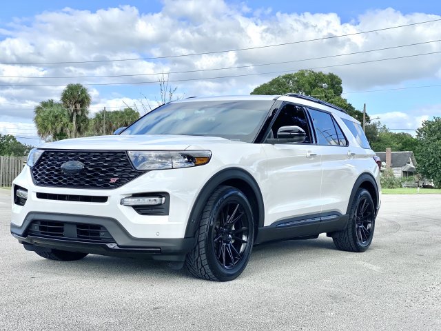

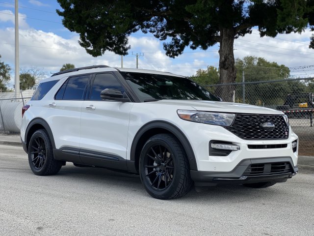

So this is technically my fiancé’s ride but she always has me set them up for her. We traded in her 2016 triple black Camaro SS that was FBO E85 on Velgens for this Explorer ST as she just needed more room for work (no kids lol)
On her cars I normally don’t go too far and just the basic. So far we have 700 miles on it and it’s gotten 20% ceramic tint, weathertechs, “explorer” removed from the hood, and had the body shop paint the emblems gloss black. Got with Adam at ZFG and he did his 93 tune on it.
If H&R would have springs available it would already have them but it’s just a waiting game now. It will be getting a whipple IC and E50 update here shortly.
Wheels are Niche Vicenza in a 20x10 with 40mm offset. Went with these as they are only 27lbs. Tires are Toyo ST3 295/45/20

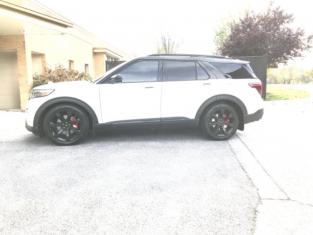

Can you share some pics showing how much the Steeda springs have settled? It may help others (myself included) figure out if waiting for H&Rs is worth it when over time the Steeda springs will settle to nearly the same levels. In the end, both springs will help improve handling. Haven't heard anyone say their ST rides worse after either spring install... so you can't go wrong in either direction. If the more aggressive drop appearance advantage of the H&Rs (subjective) is now off the table after the Steeda springs settle, then I'm sure most would appreciate saving a few bucks and going with the lower cost option.
Total drop after 1 week and aggressive driving (testing out the rear sway bar) was 1.5" in the front and somewhere between 1.25" and 1.5" in the rear--it was definitely less than the front but hard to tell exact because the tire is set so far to the inside of the fender. I will say that H&R will give you a more level look for sure--the Steeda springs give you a more raked look. Compare my truck to someone with the stock wheels and H&Rs (without wheel spacers) and the difference in the rear is there. A guy near to me has the H&R springs and in person, unless you are looking really hard at that rear wheel gap to compare the two, you can't tell the difference between the two. To the naked eye, there is no way someone could tell the front was any different.
and a super saturated version so you can see the gaps
Much appreciated! Increasing the brightness levels on the second shot helps to see the difference. Thanks(y)

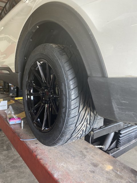

Its at the dealership now getting the Steeda springs installed. Will go to exhaust shop tomorrow to get the quad 4" black tips installed.

Drop and alignment done. The initial 5 mile drive review makes it seem like it’s much more “planted” and doesn’t have the unwanted cushy feel like a larger SUV has.
