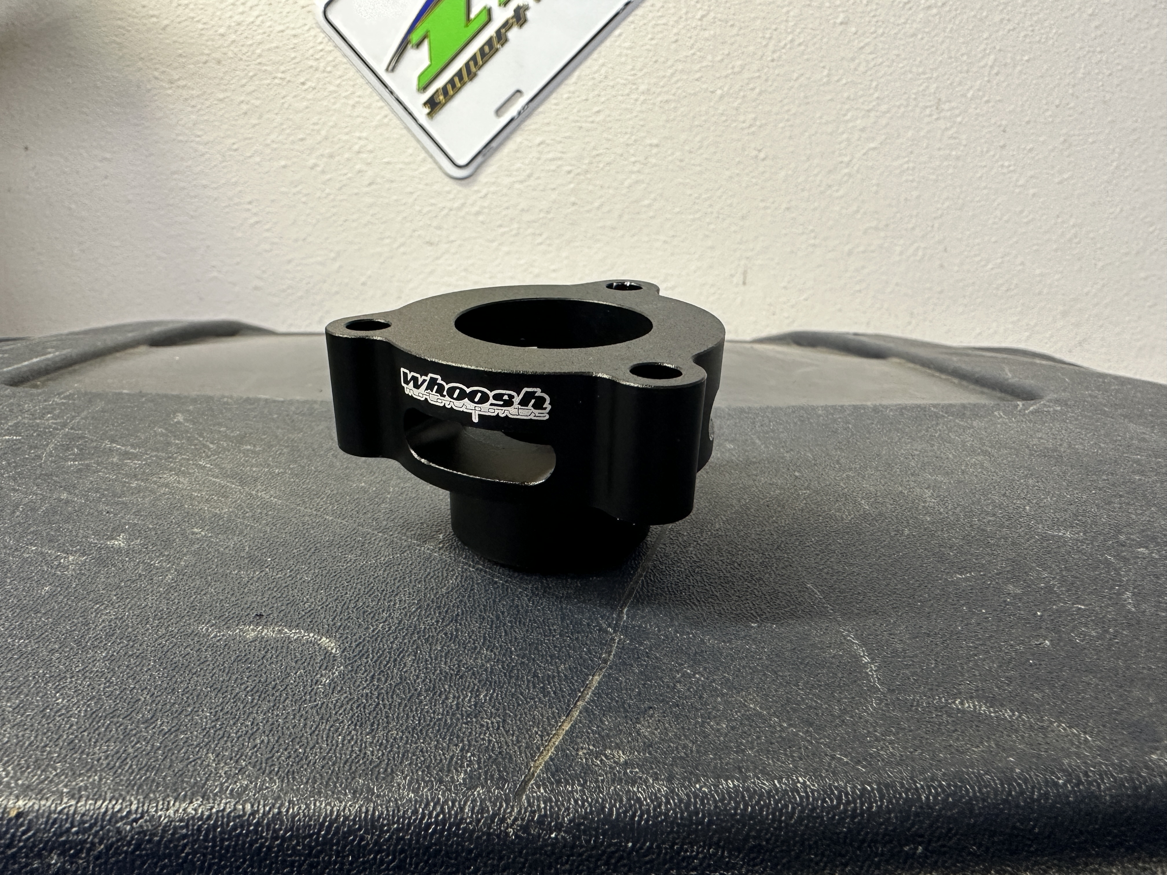

- Whoosh Motorsports BOV

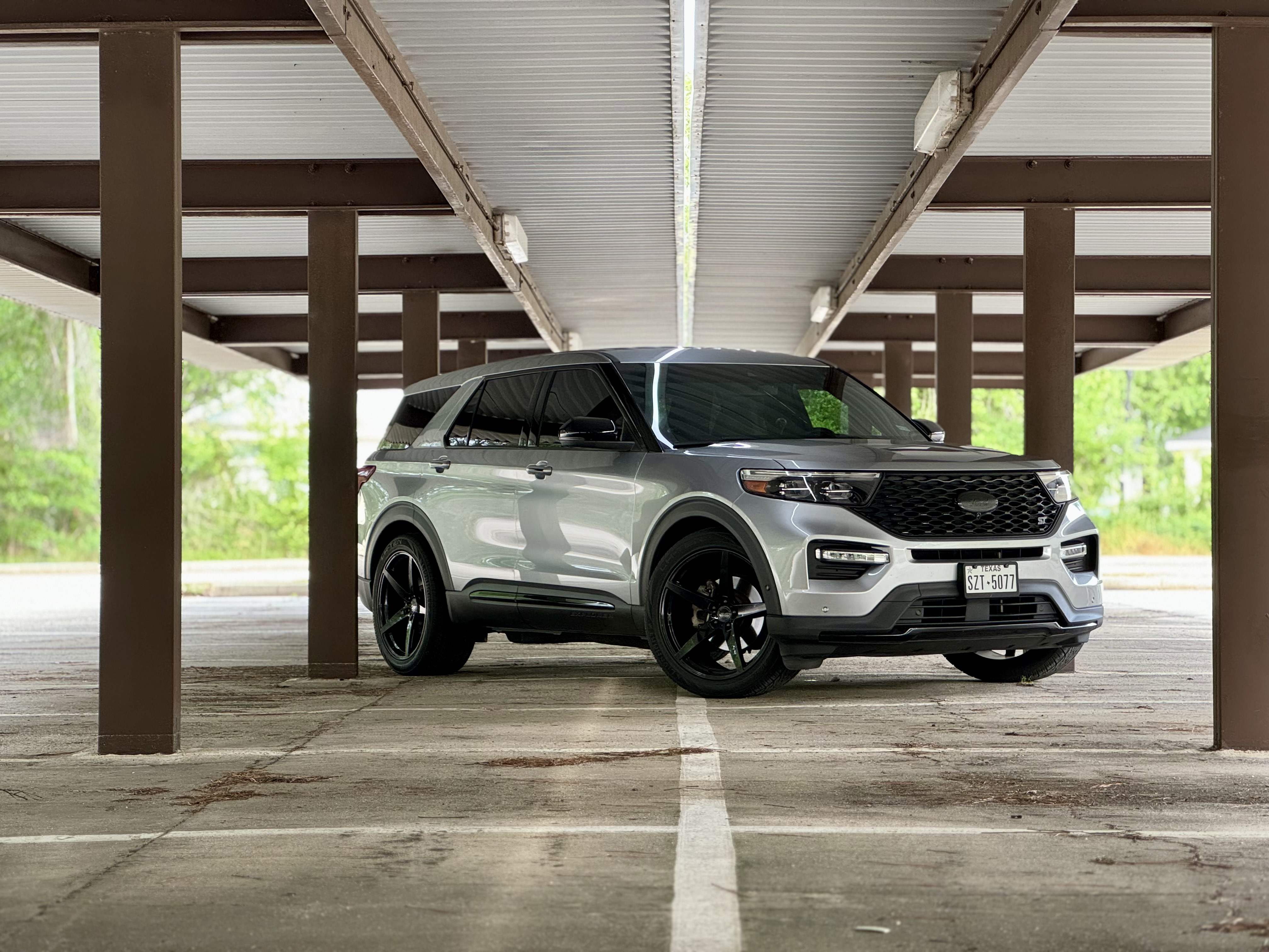

- 20x10.5" +30 gloss black Velgen Classic5 with 305/40/22

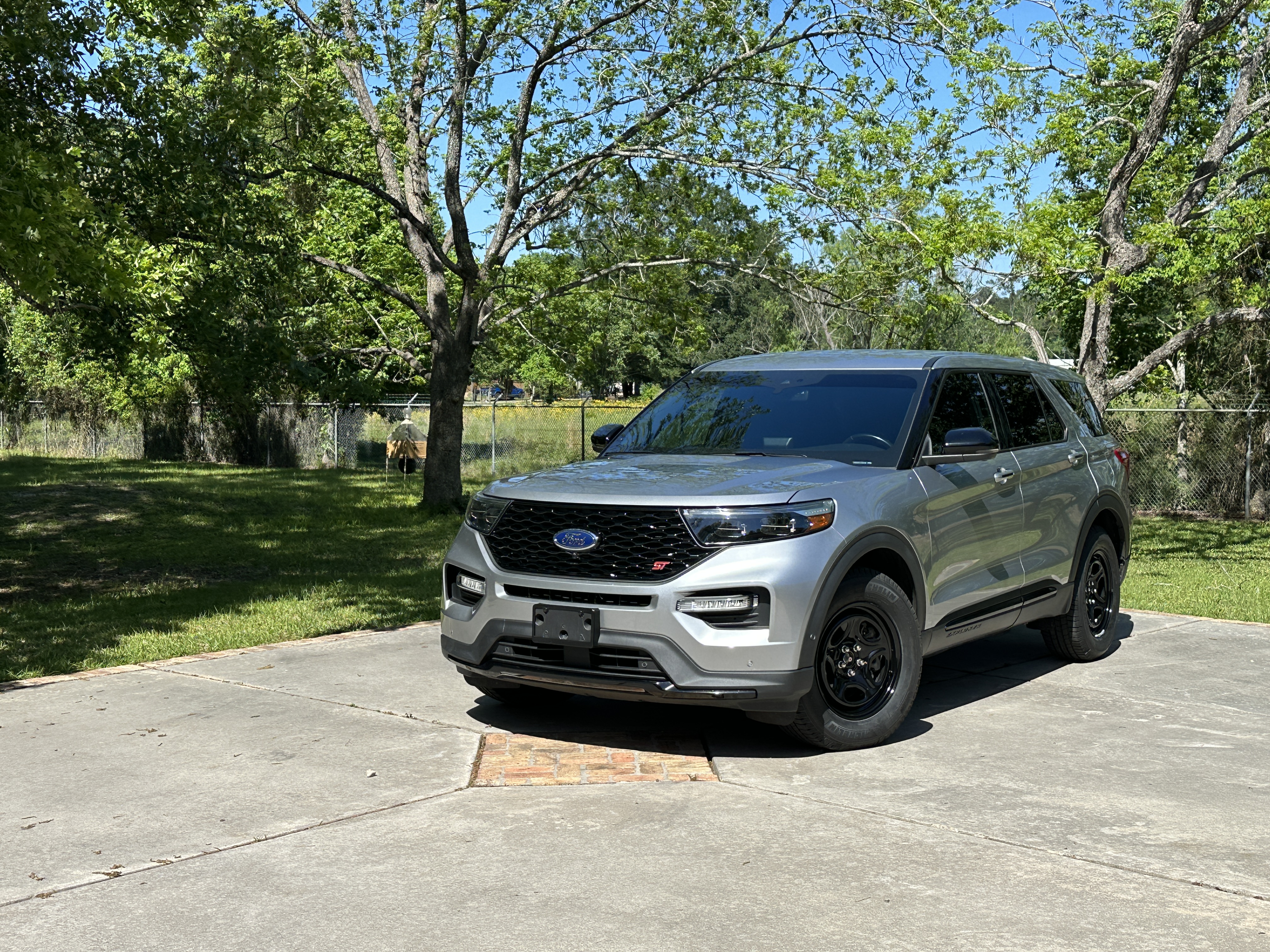

-18” steelies with caps

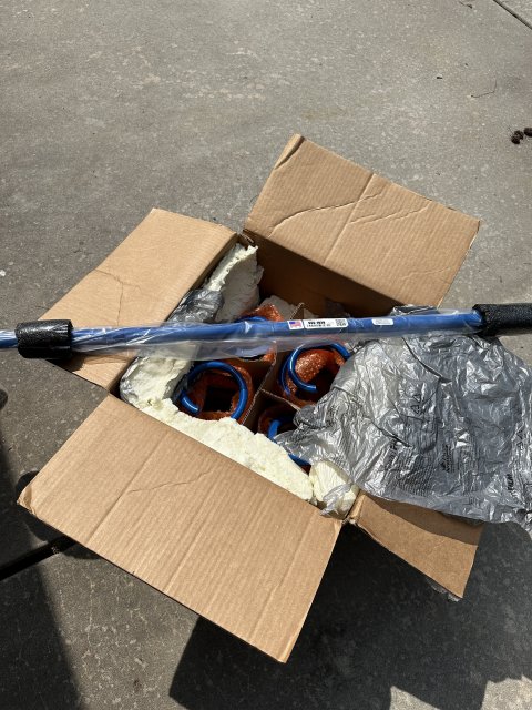

-Have Steeda springs and rear sway bar waiting to be installed.

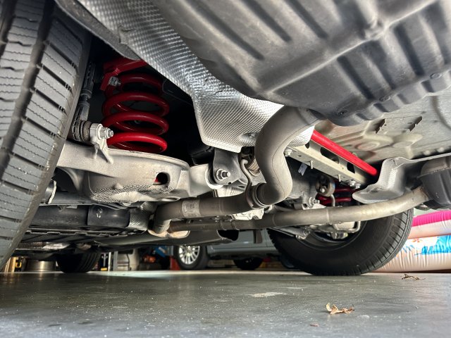

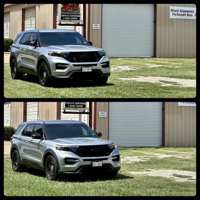

Got my Steeda springs and rear sway bar installed and full alignment. Top is before… A little over an inch lower all around and, after putting about a weeks worth of miles on it (pics are six days apart, but I went by the shop to keep reference), I can definitely tell it’s lower and is more nimble and tighter in the curves.
Hello Lawdog, nice looking ride. I'm thinking about getting the Velgens - any issues at all or with the 305s?
it’s not the 305…it’s the 40’s. 305/35/22 on 22x10.5 with a +30 offset is the magic number. Yeah, these rub ever so slightly when turning hard and hitting brakes. It “fluffs” the fuzzy liner some.
