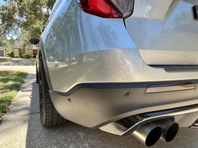

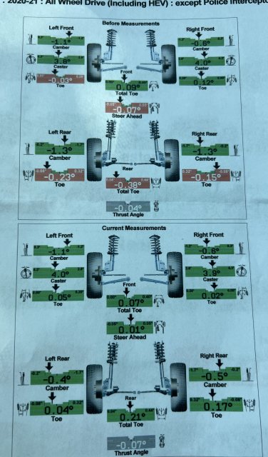

When you want absolutely perfect wheel and tire fitment ya gotta get your hands dirty. Pulled out the UCA’s and opened up the slots in the frame the achieve this fitment. I did the nasty grinding part and fellow ST owner Michael Mizler crunched the numbers. This thing sits perfect now. Before numbers are how it left my shop this morning after surgery…after is how it left his shop when he got done dialing it in.

Nicely done...that damn alignment print out was the most stressful thing anytime I modified or worked on someones suspension. Looks good!
